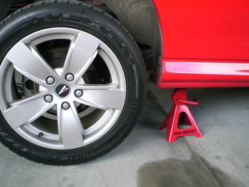

Ok first step was to jack the car up:

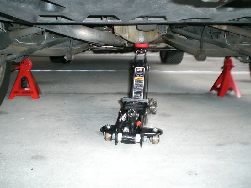

Jack from the rear differential, then put some jackstands under the car.... can never be too safe when you are talking about cars and the possibility of crushing you

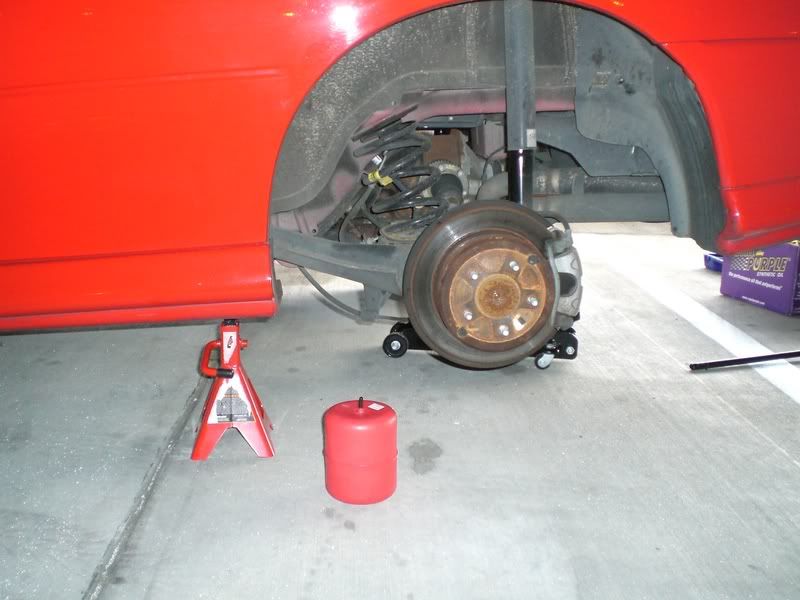

Next get the wheels off

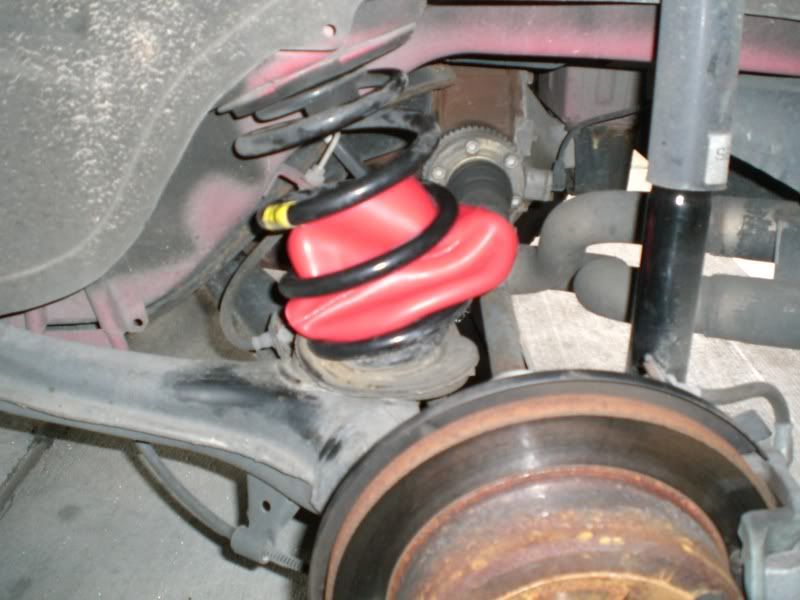

as you can see in this next picture what you are going to want to do: you want to stick that red baggy into that spring
Then get your sawzall and cut the spring stopers
Bottom one highlighted
Top one highlighted
Ok now you have done the physically hard part, next you need to do the mentally hard part, kinda like a puzzle, fitting that red baggy into the spring
as shown here, it doesnt always want to go easily,my passenger side went right in, but my drivers side didnt...... when you do this make sure the parking brake is off, it lets the rear end drop a little further, which is good

Then inflate the bags, this pushes them all the way in there and lets you adjust them to they fit right: This picture
