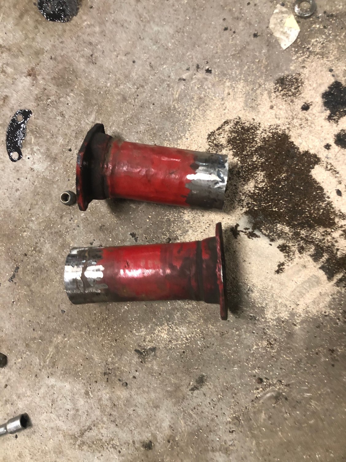

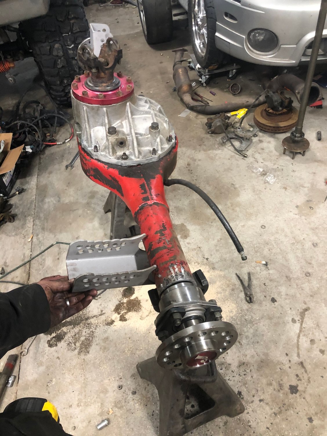

Well we cut over 16” out of the overall width, changed to an aluminum thru bolt case, backcut and rem polished 3.50’s, chromoly QP spool, backbrAce and Trick Chassis LCAB’s. Going to add an additional chromoly tube brace tying the Lcabs to the center of the diff. I’ll throw it all in the jig and weld it up.
