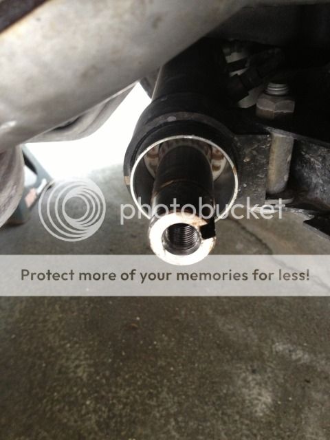

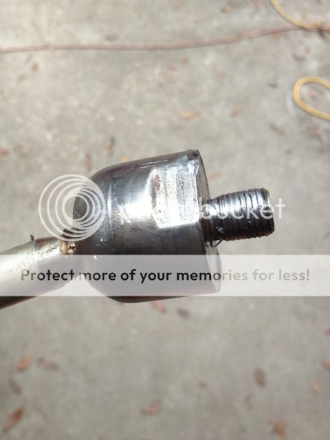

For those of you who have contemplated doing this yourself here is something I have learned. In the note from a vendor it says that the threads are peened. It will completely remove the threads from the tie rod when you remove it. You
will definitely need a 14mm x 1.5 tap (which I had to order because NOBODY has it in stock) to prepare for the new tie rod end. It cant be something simple like a 14 x1.25 spark plug thread chaser. Here are some pics of the rack end.

After 2 days waiting for snail mail finally got the tap in and 1 quick easy pass over the threads and it is perfect. Added a little red locktite and screwed in the new tie rod, slipped the boot back over, installed outer tie rod end and bolted it all back together. Done!
New tie rod installed
