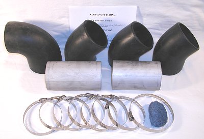

Greetings Guys; I opened this post excepting a conversation about "intakes", like in the term "Intake Manifold"! But I see it's youngin" that is tryin' to change the terms we have using since the early 1900's. I was under he impression that an "Intake" was after the Throttle Plate (s). But some how the air filter assembly - "Filter InLET" assembly is now the intake?? In the 90's when we started moving the air filter off the top of the carburetor more often the term Air filter box (usually plastic) popped up & many, me included had(?) used the term "air box". I think I heard or seen the term relating to NASCAR. Hence the filter word got dropped to "InLET box or Air box" with or without filter. So in closing I'll post what some of us Ole' guys call an Intake. I feel better now, Ole' Bob.

Im referring to a cold air intake. Te hnically there will be no air box witht the set up im trying to achieve. I see where youre comimg from for sure. But as long as i e been alive (32 years) its always been an "air intake"
