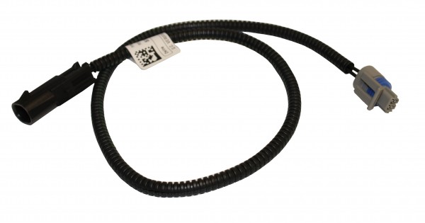

Now could i just solder extension wires onto the current connector? Will it mess with the iat readings? Or am i better off re pinning and making an extension... Or just biying an extension from casper?
Not sure how far you plan to move it but stock lenth tends to be plenty. Id cut and extend ot buy an extension, I don't solder anything anymore. Re loomed my whole harness and wrapped the iat back around to the other side of the motor
Just buy an extension. In fact, I have an 18-inch LS1 extension harness I don't need if you need one quick. I don't think Casper's makes them anymore.
are you trolling? why would you do that?
if you feel confident cutting the wires and using butt connectors and heat shrink, do that. otherwise get an extension like rich said. plenty of cheap 💩 on amazon.

not sure why casper's wouldn't sell an extention. but this is a pretty ubiquitous part.
besides caspers there's racetronix, michigan motorsports, ICT billet, lingenfelter, warr, tick, heck friggin jegs and summit probably carry it.... and dozens more.
I don't think they make them anymore. They don't show them on their website any more. But I have one I don't need.
Sent a PM to the OP.
Poor choice of words. My bad. I would cut the iat wires and extend them. I mean i uses to work at a stereo shop doing remote starts and shot. So im plenty familiar with soldering. I wa just curious because i know for exapmle manufacturers recommend agains soldering certian things (like 02 sensor wires) because it could change the resistance that computer sees.
Im also very familair with de-pinning comnectors and wires to extend them.
