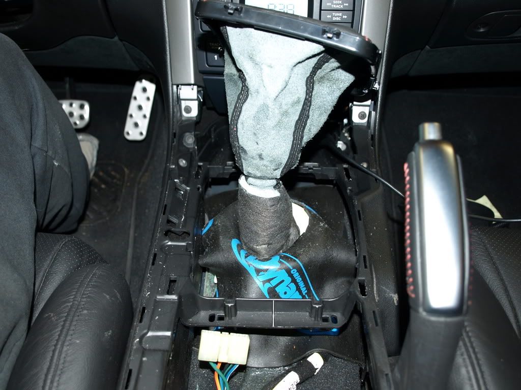

Here's the stock shifter on the GMM unit:
JHP versus stock:
Install is trivial. I needed to open the upper mounting hole a little.
(I have a double thickness of dynamat under there. It helps somewhat)

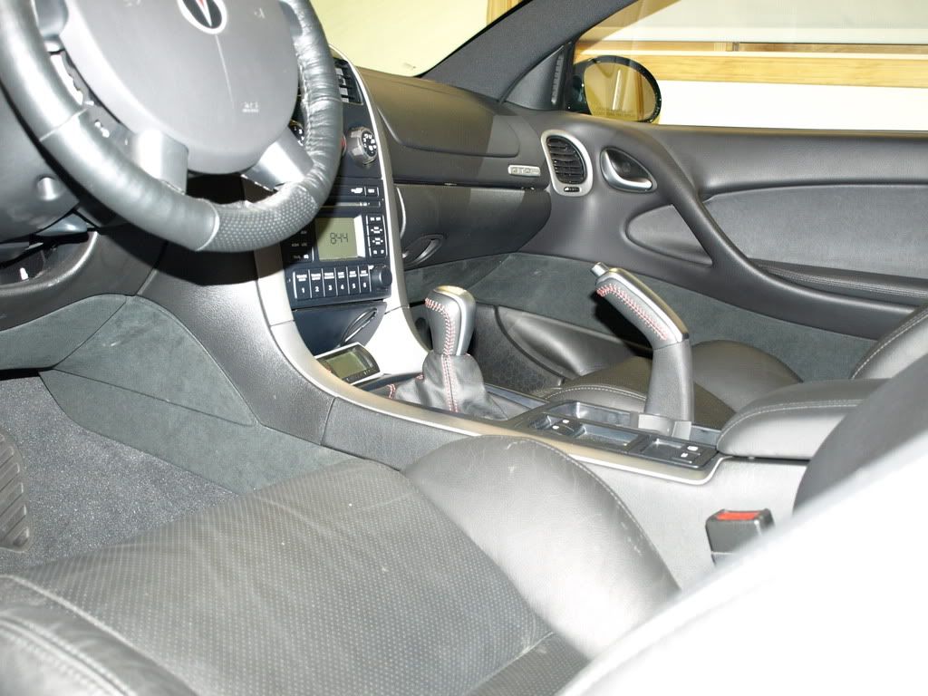

Installed:
Driving impressions (a very short and slow drive - my suspension is presently fried): just like the stock
shifter, only shorter :) There is no additional noise at all. The bushing makes a large difference.

Thats a nice option for people who want the short shift and no noise. Nice comparison. I didn't realize it was bushed like the stocker until I saw this.
This may even be an option for those with the GMM Street who want less noise.
