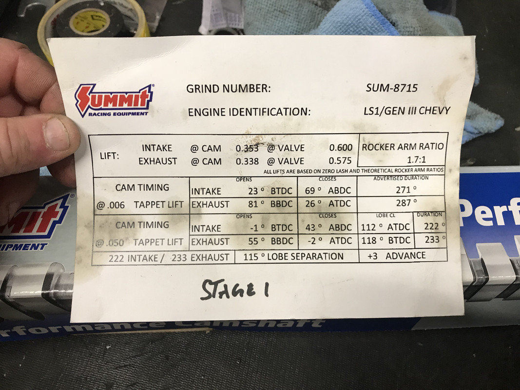

I forgot to mention. I went ahead and picked up a turbo cam. I wanted something a little more mild and suited to boost. A guy I met through ls1tech sold me a very very low mileage summit ghost cam. Has a very mild lope and will idle at a lower rpm. Plus should work better with boost. Hell, he made 450rwhp in a 4th gen f body with ported heads, fast intake and this cam. Stock ls1 bottom end. Ran ran 11.10 @ 122 all motor. It was a bit lighter than mine tho. Missing pretty much all the interior and having just a drivers seat. But still. Made excellent power.

Never really been a fan of digital torque wrenches. I like then old fashioned click.
Cam should work fine, just get springs to suit obviously.
Using the same Springs I have. This new cam is supposed to pull to 7000 also.
