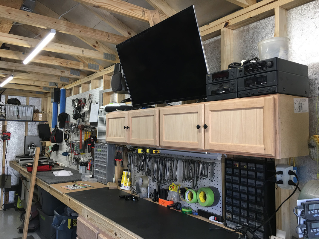

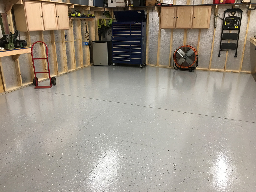

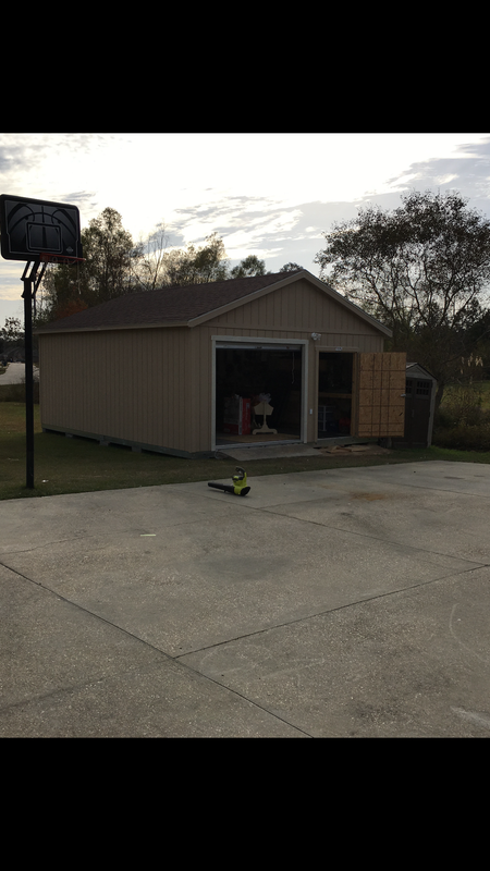

Aight fellas. Pulled the car in my shop this weekend and got started last night. Little backstory. I live in a neighborhood that doesn’t allow large builds on our lots. Well they didn’t when I bought my building. I bought the biggest one they would allow but it’s off the ground and I’ve always been afraid to drive a car in it. I finally ended up doing it with my car not long ago and it was fine, so I drove this gto in it to build the turbo kit. I insulated my shop, I have a 12k AND a 15k ac units in it. 70 degrees in the heat of the summer. Problem is, it’s small. 18x24, so not ideal for vehicles but I can make due. It’s got plenty of room for one car tho. This is a far cry from what I’m used to. I’m usually working on my car on the driveway or under the carport. Heat. Cold. Sun. Rain. So needless to say, I’m excited. I’ll post a couple pics of my little man cave shop for those maybe interested. Most importantly, all my tools and stuff are in one spot, my tv is in there so I can watch YouTube while I work and I’ll be comfortable out of the elements. Yay. Lol. Anywhoo. Please comment, give feedback, say hey or pat me on the back while I’m doing this, so I won’t feel like I’m wasting my time posting this for you guys. :)
here’s my little shop.

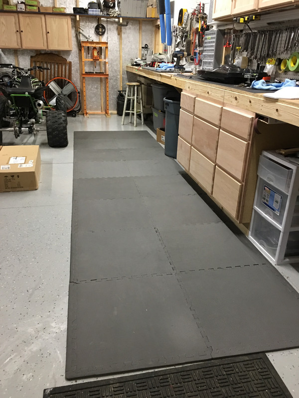

Right before I filled it up with stuff and put down padding over ha the floor (I workout in there too)
I ended up getting more Mat like this
