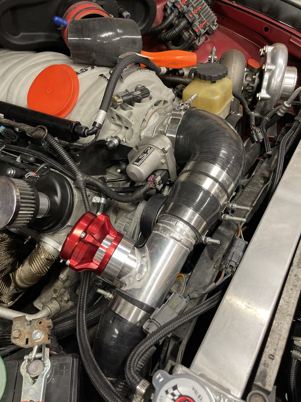

So it was time to snake the charge pipe through there. Yea I had to do a little grinding on the fan shroud. No biggie. The pics don’t really do the angles justice. It had to be able to be removed easily too....which was no easy thing to do. I refuse to cut the frame rails like ive seen other people do. Just not my style.

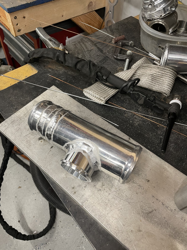

Here’s the top part where the blowoff valve goes and the fast acting iat sensor goes. He decided on a turbo smart blowoff and we are using a tial wastegate. Btw, DONT cheap out on wastegate. Blowoff, no biggie. I welded all these fittings on. Not the best welding, but not the worst I’ve seen....or

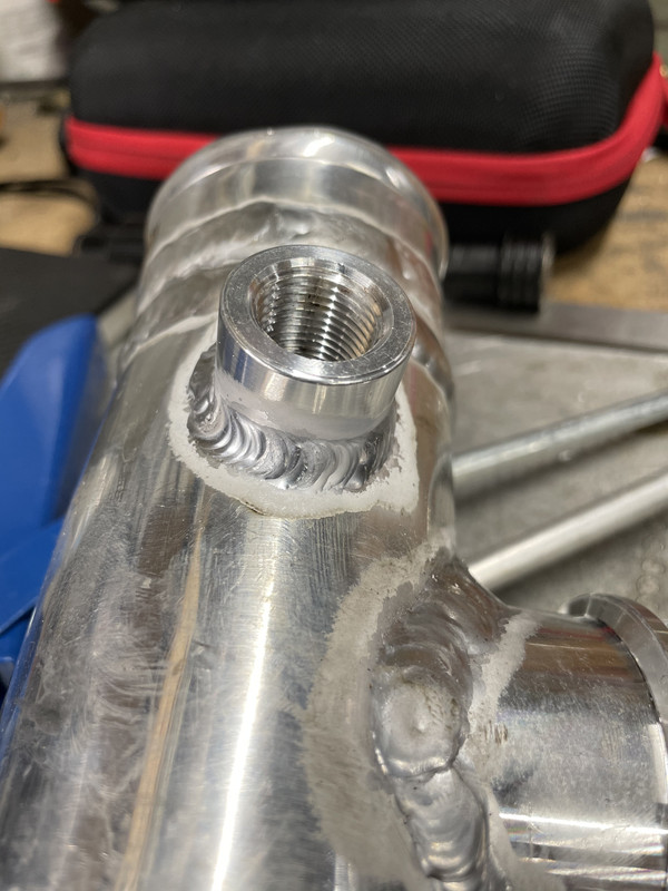

Bung for iat sensor.

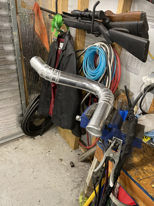

I was kinda enjoying welding the aluminum. I’m trying to get better. Although I didn’t do to well on this, the air intake. I gotta practice some more.
It’s a different length on each side do I engraved it so whoever is working on it will put it faced correctly.

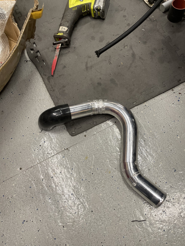

Here’s the charge pipes on the turbo side
