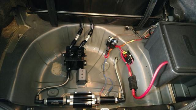

I figure I would post what the outcome of the UPP kit is currently. I originally sold my TVS1900 kit 3 years ago but lagged on installing the UPP kit. Well she is done and hopefully the engine holds up for a little while. I will list the basics below.
• Standard UPP 2006 TT kit with all hot side ceramic coated.
• Holley Dominator 12-1800 fuel pump in spare tire well.
• ID1000 injectors.
• 3” catback – Custom done locally.
• Brian Tooley stage 2 twin turbo cam and springs.
• Flex fuel conversion – Tuned on 12lbs and E85 – She put down 660 rwhp. Do not have the dyno graph but will get one next time I go to the tuners shop.
• Engine is still stock with 44K miles on the clock.

It is a return system, we are using the stock feed as the return line. Had to rebuild the holley pumps recently since I let it sit for a while with e85. Pumps froze so lesson learned.

Using a AEM tru boost controller. Waste gate 8lbs, then 12lbs on setting A and 14lbs on setting B. I run 100% E85 since it is pretty easy to find near me.
I did have to send the pumps to Holley to get rebuild since I let the car sit and they froze.

FPR is here so it is hard to notice.

You may easily pick up at least 100rwhp if you crank the boost up. You may need to go larger on your injectors though. I may be selling my ID1000's since they maxed out and we could not crank the boost up anymore.
