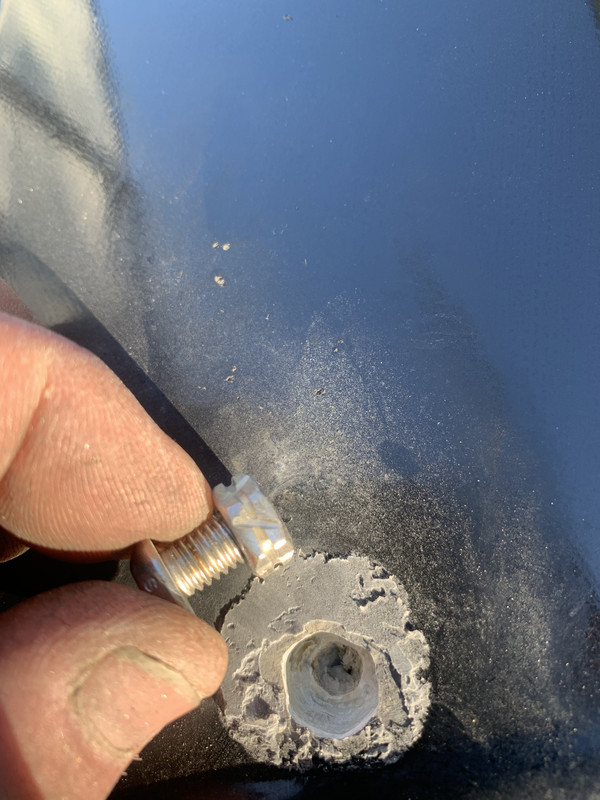

Thanks to EVIL GTO I now finally got my hands on a Mav man carbon spoiler. It was a little rough, but beggars can’t be choosers. It looked like it was cleared with UPOL, which I don’t care much for because it usually doesn’t make a nice finish but it is uv resistant. Two of the mounting nuts were ripped out too. Which he disclosed all of that to me, so I got exactly what he said I would. And thanks again buddy for hooking me up!

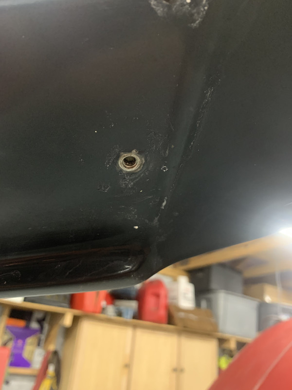

So anyways, here’s some progress pics. I dremeled out the nut hole, I cut grooves all around the nuts to give grip on the epoxy. I used jb weld 3900psi clear epoxy. That’s some pretty strong shit.
heres before
And the nut
Epoxied back in

Why didnt you put a nutsert in? Would have given it more of a grip surface. Plus i think they look better (not that anyone will see it mounted)
I have nurserts and a nursert tool. However, being this is brittle fiberglass, if I tried to crimp it in there without a washer behind it, it would just crack the fiberglass and pull out. The best way to repair it was the way I did. I have a lot of experience with fiberglass and carbon so I know what I can snd can’t get away with. Not trying to undermine you by any means, but looking at how it’s made, crimping a nut in did look like it would hold.
What did was rough up the cavity the nut was in. Then I cut a groove all around the hole. I sanded the nuts with 36 grit, then took a dremel and cut a groove all the way around, the epoxy now has a much better chance of holding it vs holding a smooth, shiney stainless nut like it had.

Oh i wasnt trying to say actually crimp the nutsert. Just use it in the same manner you did.
Gotcha. I had thought about that too. I didn’t have metric thread to match the front inserts either.
