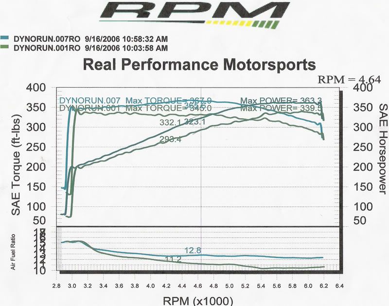

Cyclone Chris said:
what kind of dyno was it? I got 375/374 with the same mods u have except fot the corsa at the time. I had mine done on a dynojet.
Click here to watch Formato-Tuning-Day
It was a dynojet also, not sure how capable the tuner was because at the begining I told him to delete the 420 and 430 codes and all he did was clear them. So they came back later that day.
240 Posts
Discussion Starter · #6 ·
Wretched 6.0 said:
Your graph is a bit hard to read, but it looks a little rich.
And all you've done is a CAI and a complete exhaust correct?
This is correct. On that initial pull I had the shop install the plugs and wires and there was a problem with one of them. After that was corrected we got the 363 pull and that's where they quit. What file do you guys need to see what was actually changed?

Discussion Starter · #17 ·
Wretched 6.0 said:
Look at Chris's graph, the A/F never goes below 12 ussually over 13.
Yours goes to about 10, that's to rich
On the final tune (aqua color) peak hp, the A/F was 12.8 and then at 6200 rpm it looks like 12.4 or so.

Here is a better pic of the dynograph
First run was w/o tune
Second run was with a tune
Last run was with the ported stock intake manifold

BlueOnBlue05 said:
Insert dyno results here
With basically the same mods, the following are my results after my 1st dyno tune:
Then after spending time with Jeremy Formato, I had the results displayed below. Note how low the basline pull was. Nothing had been done to the car between this pull and the last listed in the first dyno results. The final dyno results are after intake porting and tune. I should note that Master Tuner Formato got these results with the car hot, after 3 back-to-back dyno pulls.
